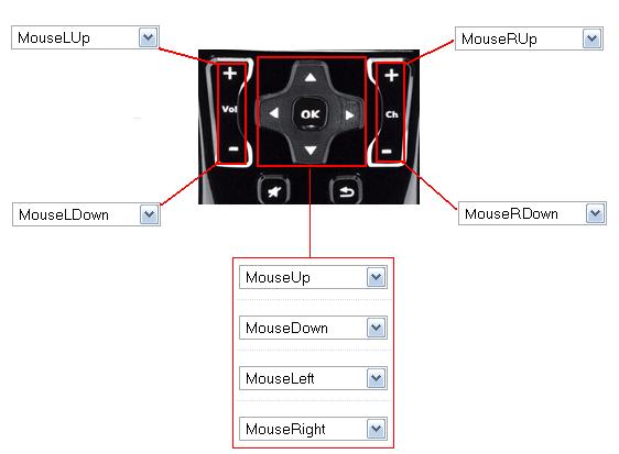

3: Rename the activity to Mouse Control
Answer Title: Renaming Devices and Activities on a Harmony remote
Answer Link: click.
4: Change the button mapping
Use the Map the Mouse Up,Down,Left<Right to the direction buttons.
Map the Mouse Left Up and Mouse Left Down to the Volume Up and down buttons.
Map the Mouse Right Up and Mouse Right Down to the Channel Up and down buttons.
Below you wil find an image with an example.
Gruß AEOne
